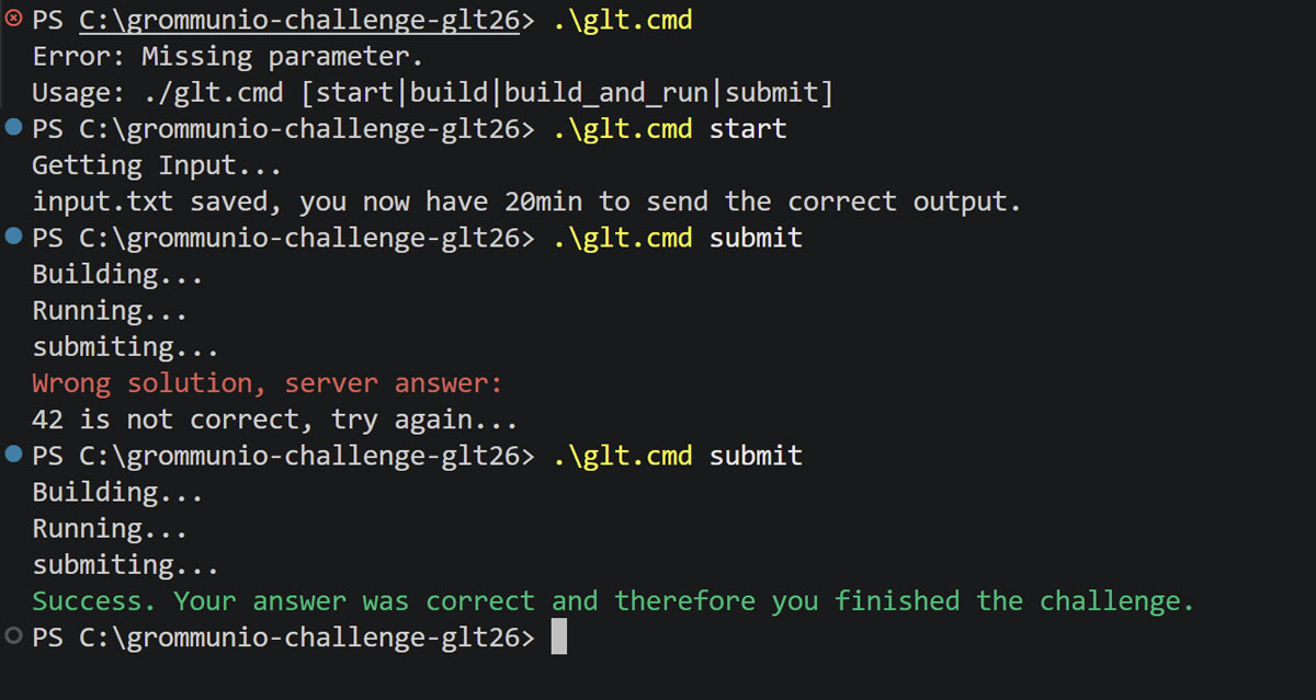

This challenge requires you to write some C/C++ code inside .\src\main.cpp to solve the challenge at the end of this readme. It uses MinGW64 with gcc/g++ 15.2 which is set up automatically in a local directory and can be used with the following commands.
There are four important commands for the included script:
1. To Register your E-Mail address and start the 20min timer:
.\glt.cmd start
2. To just build your code:
.\glt.cmd build
3. To build and run your code and print it’s output to the terminal:
.\glt.cmd build_and_run
4. To build, run and submit your solution:
.\glt.cmd submit
The command used to build your solution has no optimizations enabled by default:
g++.exe -static -O0 -g -std=c++17 src\main.cpp -o build/app.exe
Challenge
To start the challenge, first put your E-Mail address in the user.txt file and then use the start command to get your input. We only use it, to contact you in case you win the drawing. You only need to change the result variable in your code and then run the submit command to check whether it is correct.
